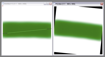

I have made some screenshots of the problem (PWP 6.0.9, 32bit,. WinXP)
I created a square image, 400 x 400 pixel, just drawed in a green line to have a reference.
Used Level for a little correction.
Fist image shows the standard preview (1:1)
Then Left click in the preview, Zoom in and resize
It shows just a part of the image, no scroll bars, as it does in other transformations under similar circumastances.
The various options in the Toolbar of level do not affect the result, is the same in all settings.
