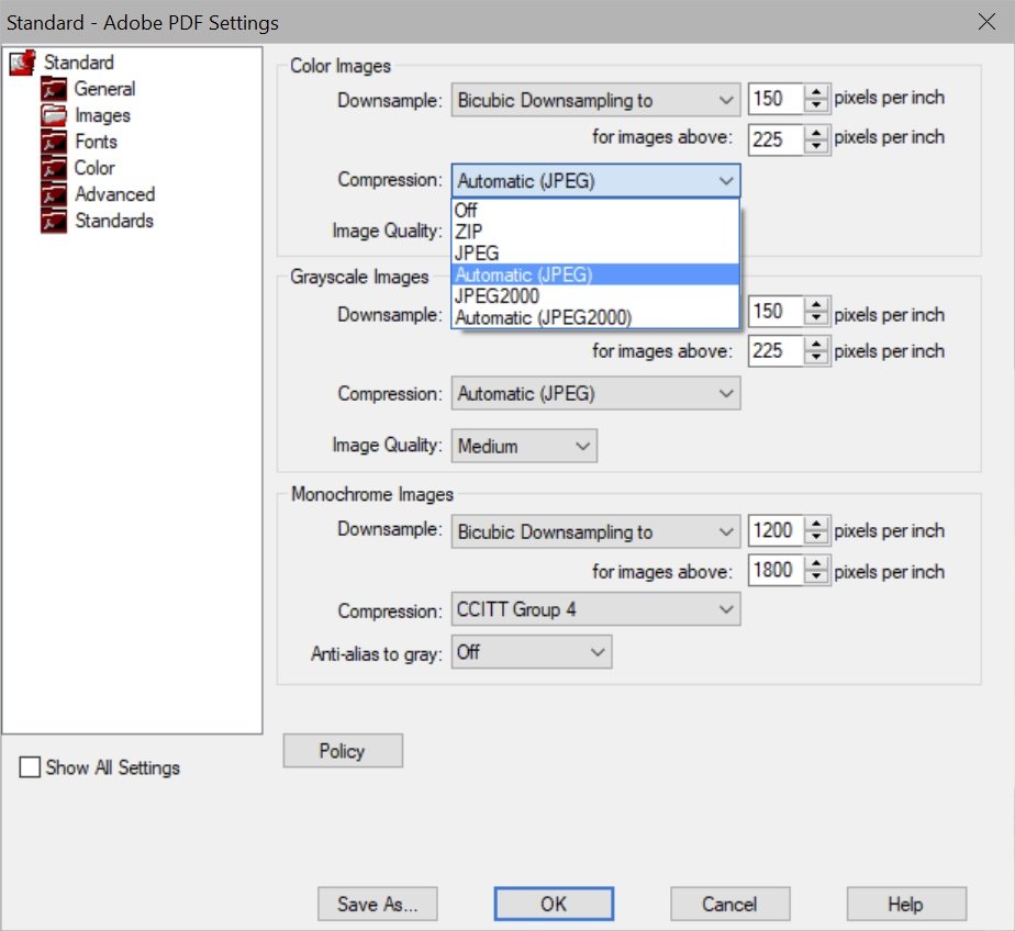

Re: A question about pdf
PDF commonly saves images as JPEGs, but the size will depend on the JPEG quality setting. The Adobe PDF driver gives you the option of saving uncompressed images.
