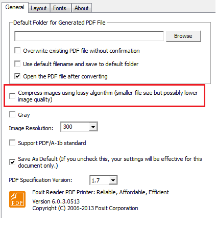

I currently use Foxit Reader in my PC. Its driver offers one important setting regarding quality. The default is ON.
I will try the Adobe PDF printer driver to see if it is more sophisticated.

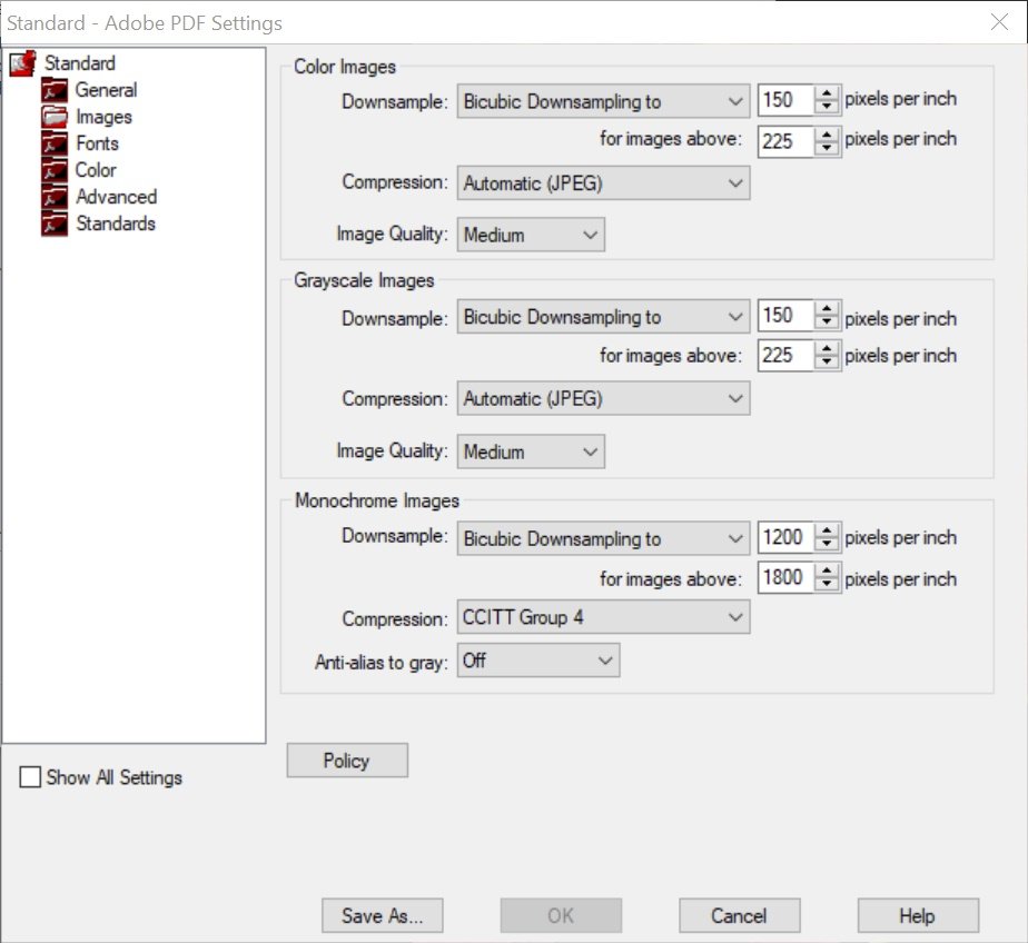

Here is a dialog box for Adobe PDF:
Not sure where I got it, but I think it came with Acrobat.
