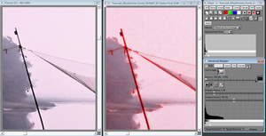

Here is the illustration of the setup:
From left to right, clockwise: output preview window, input window (with mask in red), texture Mask control window, AS (sharpen tab) control window.
Note: this method tries to block halos on major edges that AS can produce. It does not separate white and black overshoots - reducing only one of them (typically white halos on the bright side of the edge, as in this example) could make the sharpening even more effective, and the image more pleasing overall.

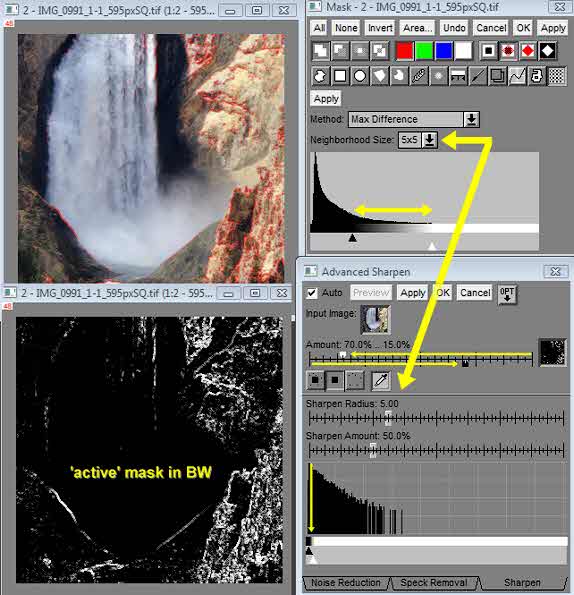

This is an addendum to Maciej's discussion above with additional illustrations resulting from a recent intense series of experiments of PWPro 32 v7.0.12's Advanced Sharpen - Sharpen tab...
...the following seems to be reasonably generic for 3456x2304 pixel, 48-bit color, nature landscape images with fine [small] detail...
While the suggested major edge mask does not separate and make adjustable the edge dark/light undershoot/overshoot:
...it does provide a gradient from the major edge with the largest contrast to edges with lesser contrasts within the selected edge threshold range where the black slider sets threshold and the white slider adjusted to the right most end of the histogram provides the largest to lesser edge contrast gradient...
...if the Mask tool - Texture's Neighborhood Size is set to the AS-Sharpen Radius, then the masked edge widths are nearly that of the edge pixels affected by AS...
...preserves the AS sharpening effect to the majority of the Input image areas represented to the left of the black slider's histogram Threshold setting...
...allows setting the AS sharpening effect to the major edges to a lesser amount where the dark/light undershoot/overshoot will not be objectionable...
The illustrated AS - Sharpen tab settings are my 'Save As Default' settings:...
...Sharpen Radius 5; Sharpen Amount 50; Threshold (black slider) just to the right of the histogram peak; and Blend (white slider) pointer beneath the Threshold bottom right corner...
These initial settings will generally produce an over sharpened Preview [1:1 Zoom factor to avoid anti-aliasing artifacts] image whose minor/major edge contrasts amounts can be reduced to preference using the black/white AS transform Amount sliders when the 'active' mask is selected...
Perhaps to be more technically correct the suggested major Edge mask should be applied to the Extract-ed RGB-Luminance channel of the AS Input image rather than the Mask Tool - Brightness Curve's starting image's HSV-Value histogram but this is a nuance that will go largely un-noticed for most photo-realistic images...
The attached illustrations show a 1:1 Zoom factor IMG_0991 [Lower Yellowstone River Falls & Canyon] image area crop at a 70-75% jpeg compresion for posting... ...the bottom illustration shows a Preview where both mask black = mask white = 100 or 'No Mask'.
