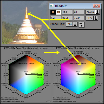

The following color hexagon illustration indicates the reasoning/analysis for the suggested Defringe transform settings...
The 'bloom' has a 7.2% Hue and a 53.2% Saturation in the HSV color space model... ...the Defringe default Hue and Saturation range is roughly 67 to 100% Hues with 0 to 100% Saturations [shown bottom left]. The transform's Hue sliders were moved to a narrow Hue range that included the image's probed 7.2% Hue/53.2% Saturation 'bloom' with the blending sliders/Radius/Threshold/Amount adjusted to a preference for the needed 'bloom' reduction [shown bottom right]......in this manner with the aid of the Readout Tool and a reference color hexagon, one can select preference Defringe transform Hue ranges that differ from the 'default'... ...just use a reference color hexagon image as the initial transform Input image, set the Hue sliders, then change the Input to the 'bloom'-ed image to adjust the remaining settings...
