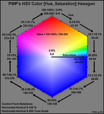

Marpel's original image has a dominate HSV-Hue histogram distribution at a 57% Cyan hue [145 hue on a 0-255 gray scale]... ...with a 2% Red hue [5 hue on a 0-255 gray scale] for the islands and waterline horizon...
To help illustrate... here is PWP's standard HSV-HS Color Dialog hexagon with notations...

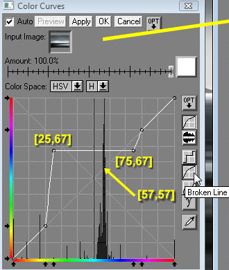

This is a suggested HSV-H Color Curve to shift Green-Cyan hues to Blue and preserving Magenta, Red, and Yellow for Marpel's image...
When this curve is applied to the Color hexgon, it becomes...
Marpel's original image with suggested hue shifts can be viewed here: http://www.ncplus.net/~birchbay/marpel/index.htm
Using the HSV color space to shift only the Hue leaves the Values (tone) and Saturations essentially unchanged from the original... ...and as Jonathan's alternatives suggest, there is more than one way to accomplish this change.
