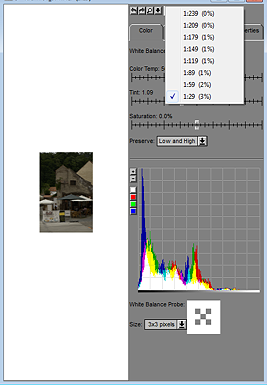

Sometimes, if a picture is opened in the raw dialog from the Browser window extended over most of the monitor screen, the raw preview can result very small without an option to enlarge it any more. I have never been able to simulate it. It just happens sometimes. Or does anybody know when this happens and how to avoid it?
By the way, opening the raw dialog outside the screen - due to the extended Browser window - takes much longer. It is no problem perhaps except it may create the impression that the processing got frozen. However, if you know it, you will expect it.

If you want to view the browse window at nearly the size of the full screen, the best way to do so is to undock by dragging it by its title bar into the center of the workspace. Then other windows you open will display on top of it and will use the full display area of your screen. After you are done using the browse window at its large size, you can redock it by dragging it to one of the edges of the workspace.

A very good idea about the undocking. And what is even better is that if the browse window is closed instead of redocked, it remembers its size, though it cuts a bit of its height. I wonder why I did not think of it myself.
