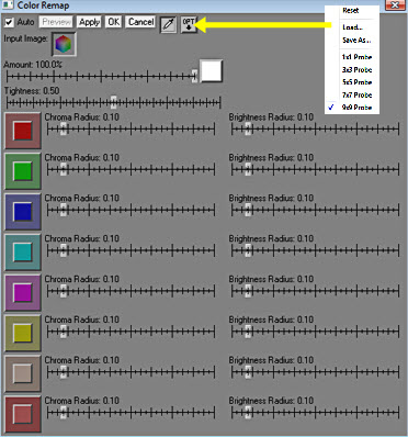

Current version of the Remap transform does not load the Chroma and Brightness radii settings from the 'saved' file...
Probe size, Tightness, and ColorPairs [outer/inner squares] load successfully.
Test OPT-Save As file in *.colorremap.txt form:
ColorRemap 1.0
ncolors 8
tightness 0.500
probesize 4
color 0 127 85 85 153 15 15 0.2029 0.2527
color 1 85 127 85 15 153 15 0.2029 1.0000
color 2 85 85 127 15 15 153 0.1981 1.0000
color 3 85 127 127 15 153 153 0.2029 0.4956
color 4 127 85 127 153 15 153 0.2029 0.5044
color 5 127 127 85 153 153 15 0.1805 0.5044
color 6 128 115 107 154 138 128 0.2478 0.5044
color 7 128 64 64 154 77 77 1.0000 1.0000
end
Resulting OPT-Load Remap transform dialog:
loaded Remap dialog.jpg (47.18 KiB) Viewed 5612 times

Actually it is reloading the values, but it is not updating the sliders. Will fix for next beta.
