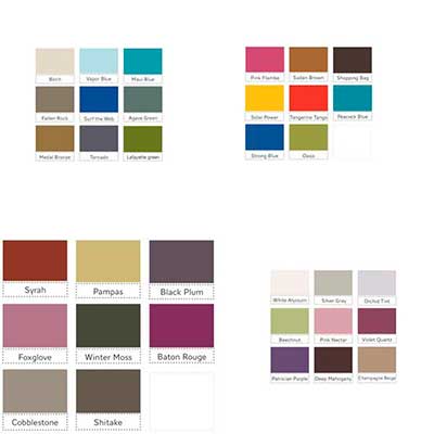

I have a JPEG image which contains approx 20 - 30 squares of solid colour (2013 colour trends), which I frequently reference to tint some of my images. My current method seems somewhat cumbersome, so am looking for advice on ensuring accuracy and speed. One of the biggest hurdles is related to the fact that each colour is not only different in hue but also different in tone. My current method is as follows:
Open an image. Open the colour swatch. Open the Brightness Curve transform. Use the probe on the swatch to determine where the swatch brightness is located on the curve (no curve manipulation necessary). Remember the approx location. Close the curve transform. Open the Tint transform and place a point on the line that is relative to the location on the curve. Double click the point to open the colour probe tool. Probe the swatch and apply that colour.
The problem is twofold. The Tint and the Curve transforms can not be open at the same time (at least I can't figure how to do so), so I am forever opening and closing each to use the other. The second problem is, as already mentioned, each colour square is not the same brightness so I can't just place a generic point midway along the Tint line. For it to be accurate, the point needs to be at its correct location and although in my current method, I can get pretty close, by eye, it would be nice to have the two points match exactly.

I am attaching 2 images; one of the colour chart and the second of an image I am currently working on. In the work in progress, I used the chart to get some of the colours from the group in the lower left (cobblestone, shitaki and moss green so far I think). The issue is, because the colour patches have different tones (e.g. the cobblestone is lighter in tone than the green or plum), I don't know where to place a point on the Tint line, without opening the curves dialogue and using the probe on the colour patch, then remembering where it was located and trying to place it in the same location on the Tint line. If I am using multiple colours from the patches, I am constantly opening and closing the curves dialogue. I was hoping someone had a better method. If I merely placed a point on the Tint line in the middle for, as an example, the cobblestone or light colour, the resulting image is blown out. Moving the point once the hue is chosen, often results in the left side darkening too much and the hue changes somewhat. I have not tried your suggestion yet of equalizing the colour patches, but I think it would change the patches, would it not? Or am I over-thinking this.

Rather then using Tint... perhaps ColorCorrect or Remap would be a better choice to substitute the Hue and Saturation of a swatch for the Hue and Saturation at a particular Value [tone] in the image...
ColorCorrect is the easiest to describe and perform...
(1) click on the image...
(2) open ColorCorrect and with the ColorCorrect Probe, click on a color swatch... ...a Hue and Saturation control point is placed in the color hexagon...
(3) with the ColorCorrect Probe, click on a H,S, and V in the image that you wish to change [a mid-tone tree bark color, for example] to the H and S of the swatch... ...this establishes another control point on the color hexagon...
(4) drag an arrow head from the (3) control point to the (2) control point...
(5) adjust Amount and Radius to preference. Note also that brightness (V or Value) can be changed if preferred whenever a control point is 'active'...
(6) repeat (1) to (5) to add other swatch H and S's to the image's V's...
Remap could also be used and offers better control for blending H, S, and V changes for specific color pairs... ...but its use is not as simple to describe.
Note: the Color Correct and Remap transforms are based upon the HSV color space model... Hue, Saturation, and Value.

More specifically to this thread, the following will create a duo-tone effect by adding "Winter Moss" green to the tree bark tone/colors using the Remap transform...
(1) Use the Reamp Probe to select a tree bark H, S, and V.
(2) Double left click on the Outer color pair to open the Color 1 dialog. Change its color space readout from RGB to HSV and note V [Value].
(3) Double left click on the Inner color pair to open the Remapped Color 1 dialog. Change its color space readout from RGB to HSV.
(4) Use the Remapped Color 1 Probe to select the 'Winter Moss" swatch. Enter V value from the Color 1 dialog or move the vertical color bar slider until the V equals the Color 1 V [or to a brighter or darker tone if a preference].
(5) Adjust the Remap color change Tightness and Amount to a preference generally leaving the Color Pair's Chroma and Brightness Radii at their default settings.
