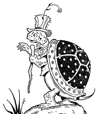

Hi Bob & Jonathan,
Thanks, both your ideas -- resizing using nearest neighbor instead of bicubic, and sharpening afterwards -- worked great. I would have been very happy with the results using nearest neighbor, but using bicubic and then doing heavy sharpen at 100% looked even a bit better.
Since both looked good separately, I also tried using both nearest neighbor and then sharpening, but that did not look good.
I'll post the result here. I had to crop it to meet the max posting size here.
Greg
Greg
- Scanned at 1200dpi, then resized to 150dpi with bicubic, then heavy sharpen at 100%. Had to crop it to be able to post it here.
