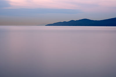

I have been editing some early morning shots, taken on a Nikon and initially RAW processed in NX2. The extent of the NX2 processing was to do a little WB, turn off sharpening and extend the range so the histogram showed a full range. In the photo of interest, the channels, of course were not perfectly equal so the range was set to the edge of the whichever channel extended the farthest to ensure all channels were left unclipped. This was done as best as possible by eye as I find NX2 somewhat difficult to do this precisely. At the very least, I am confident there was no complete clipping at either end. I then saved the image as a 16 bit Adobe RGB TIFF and opened it in PWP (ver. 5).
I accessed the Levels and Colour Transform and the Dynamic Range slider showed 31.8% and 98.4%. As I was surprised the shadow end was so far over, I used the Readout Tool and measured the piling along the waterline towards the right side and took multiple readings within the piling, all of which showed 0,0,0. The measured area was about 18 X 30 pixels in size. My first questions are - How large/small an area does PWP measure to determine the initial Dynamic Range? and If the RGB channels are not equal so, say, Red is farther towards one end, for instance the shadow end, than the other two, does PWP recognize this and place the Dynamic Range reading to ensure this channel is not clipped or does it find the first spot where all channels are clipped? I would have thought it would be the former, however, I find NX2 will show clipping at the shadow end when even one channel is clipped while at the highlight end it will only show clipping when all channels are clipped, so I am unsure about this in PWP.
Another issue - I decided to only set the highlight end to 100% and left the shadow end at 31.8%. Once complete, I happened to notice a strange tone in the same area of the pilings that I had been using the Readout Tool. It was initially black, but changed to a strange brown in the finished image. As I thought it was a bug/problem related to the use of the Readout Tool, I closed the initial image, closed and re-opened PWP and did the same Transform (only extending the highlight to 100%) without using the Readout, but the result was the same change in colour. The even weirder thing is the change took place in the dark end, not the highlight end.
I have attached two images (if everything works out, I have not tried this before). One is the reduced full size image, to give you an idea of the size relationship of the pilings and the second is a crop of the pilings with the strange colour. Although the original is 16 bit Adobe RGB TIFF, these two are JPEGs.

After doing some math, it appears the area that I measured (about 18 X 30 pixels) with the Readout Tool, was indeed less than 0.01% (the image is just over 6000 X 4000 = 24,000,000 pixels and 0.01% is 2,400 pixels or 60 X 40 in size - interesting, seems to be a rather large area, but I guess because the image is relatively so much larger....), so you were bang on there. And, thanks for the suggestion to use an expanded histogram in the Brightness Curve to ensure against inadvertently clipping pixels.
However, your reference to taking black pixels and going from 0 to 31% confuses me, because I did not change the dark end of the image, all I did was leave the 31.8% as it was and moved the highlight end slider from 98.4% to 100%. The result was those black pixels, which were apparently ignored in Levels and Colour, being changed to a lighter, brownish colour, as in the cropped image in the attachment, which does not seem logical.

Although I think I understand your explanation, it seems bizarre that increasing the DR at the light end by only 1.6% can have such a marked effect on some of the darkest pixels in the image.
