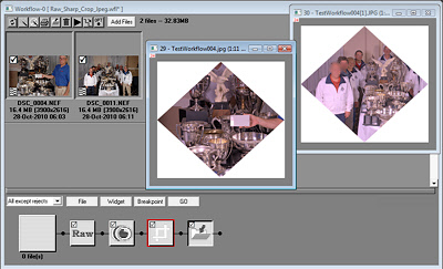

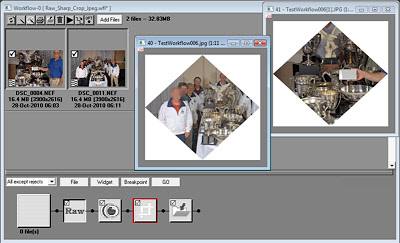

For me the workflow completed satisfactorily for two NEF files in Multitask mode with the following observations:
(1) the RawDialog widget provided a 'reddish' colorcast and the 1st display image processed first
(2) the display image check marks were cleared; RawDialog widget White Bal. Probe was used on the gray card of the 1st display image; and the wfl runned again
(3) the 2nd display image processed first with both images having satisfactory WB
Could there still be a White Balance [Probe?] issue for the Raw Dialog widget?
