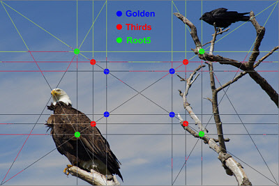

Illustration -- (the blue, red, and green dots are for illustration purposes only and will not appear when the suggested changes are implemented): The suggested 'txt' changes could be modified to show only the third's grid if desired, i.e., ....
CompositionGuides 1.0
begin
verbose 0
begin_object
name "The Thirds Guides"
horizontal 0.3333
horizontal 0.6667
vertical 0.3333
vertical 0.6667
end_object
end

Thanks Den - I was afraid that the guides were hard-wired. Awesome, I just added the Thirds guide and it works - it's almost like joy of programming...
