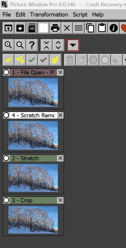

problem : crash while using scratch removal tool
Posts: 744
The scratch removal transformation was not included in the abnormal termination recovery. Recreated the transformation for illustration.
2026-01-23 PWP crash using scratch removal tool.zip
(311.6 KiB) Downloaded 85 times
Hopefully you can find the cause of the crash in the zip file
2026-01-23 212519 PWP.jpg (69.79 KiB) Viewed 4663 times

Re: problem : crash while using scratch removal tool
The workspace file you sent does not include a scratch removal transformation, so there is no evidence of a crash in the files you sent. What I need to reproduce the problem here is a sequence of operations that reliably produces a crash.
