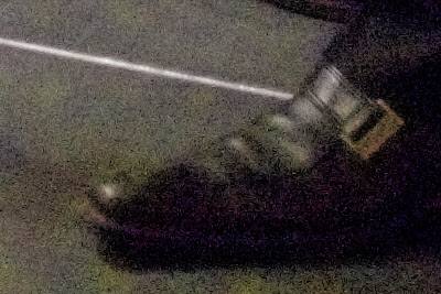

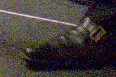

The closest one might come in PWP is perhaps: (1) normalize an image's blurred H and S channels from its Lightness to a 50% tone and (2) Composite-Hard Light the result with the image's Luminance channel... recognizing that for the HSL color space model, the H and S plane is at a 50% tone and the Hard Light filter will brighten for any tone greater than 50% and darken for any tone less than 50%...
Let Img0 be the starting image...
1 to 1 image area_ori.jpg (47.31 KiB) Viewed 8291 times
(1) Extract Img0's Luminance channel, creating Img1
(2) Gaussian Blur Img0, creating Img2 [for the illustration, the blur was 10]
(3) Apply a HSL BrightnessCurve [0,50], [100,50], Amount = 100 to Img2, creating Img3
(4) Apply Composite-Hard Light where Input = Img3, Overlay = Img1, and Input/Overlay Amounts = 100; click OK, creating the reduced chroma image...
1 to 1 image_reducedChroma.jpg (47.87 KiB) Viewed 8295 times
The illustrations are 1:1 resolution 400x267 image area crops of a Panasonic DMC-GH2 converted RW2 file, whose ISO was 1250...
Composite-Soft Light will produce a softer ambience in step(4) if a preference.
This seems to work well for images in my files... How about yours???
