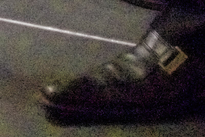

Here is an example of what I'm trying to do. The only difference between the 3 crops is chroma noise.
A - no chroma noise reduction
B - chroma noise reduced in PWP - AS.
C - chroma noise reduced in DPP
The original blue/yellow multipixel blotches (A) become darker/lighter spots when PWP-AS (chrominance only) noise reduction is applied (B). DPP (C) chrominace noise slider reduced colour variance without touching the luminance noise.
What's the difference between these two methods? Is the difference the method of noise reduction or the chroma channel(s) separation?
Is there another way of dealing with the chroma noise in PWP? I tried blurring H or S channels, but went nowhere.

I'm not sure if it's helpful, but I just looked at the same image in NeatImage, which can separate noise frequencies. The 'blue/yellow' blotches are v. low frequency, mostly in YCrCb-Cb channel or, a bit less decisively, in RGB-B channel.
