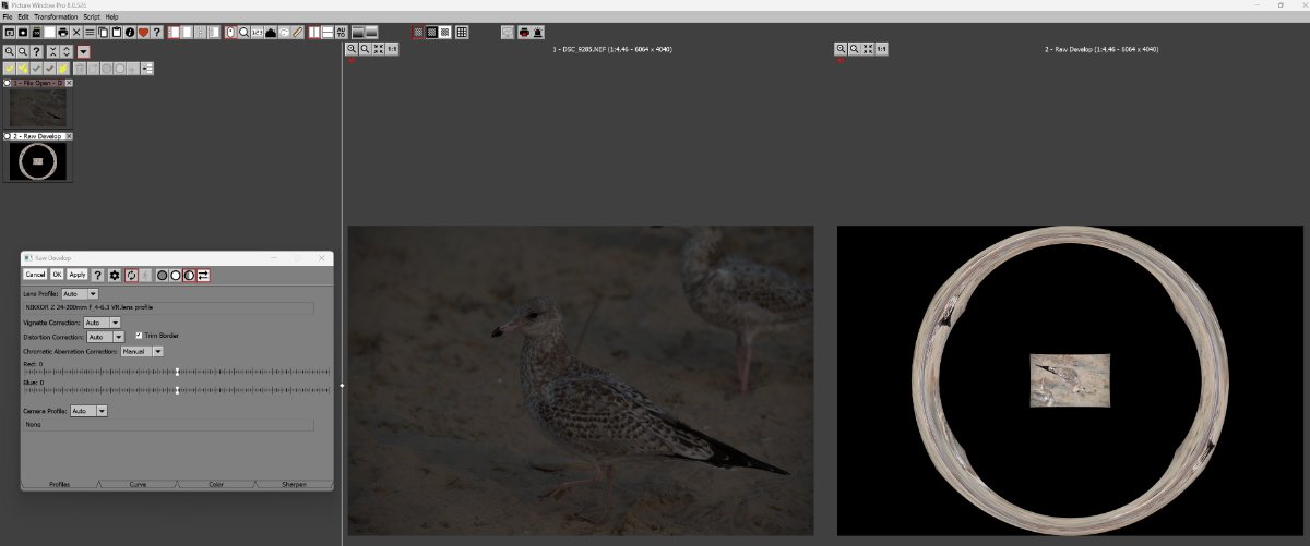

See screenshot of strange lens profile result.
Nikkor Z 24-200 , Nikon Z6 camera body
2025-09-03 PWP raw develop.jpg (55.38 KiB) Viewed 77952 times

Try deleting all the files in the Lens Profiles settings (C:\Users\<user name>\AppData\Local\Picture Window Pro\Lens Profiles. This will force PWP to rebuild the lens profiles using the latest database.
Re: problem : raw develop strange lens correction
Posted: September 3rd, 2025, 2:21 pm
by pierrelabreche
jsachs wrote: September 3rd, 2025, 11:28 am Try deleting all the files in the Lens Profiles settings (C:\Users\<user name>\AppData\Local\Picture Window Pro\Lens Profiles. This will force PWP to rebuild the lens profiles using the latest database.
After deleting all files in the folder, the problem persists.
Posted: September 3rd, 2025, 2:26 pm
OK, please send me a copy of the raw file.
Posted: September 3rd, 2025, 4:21 pm
It looks OK here. Can you tell me what are the names, sizes and dates of the files in your Lens Profiles folder?
Posted: September 4th, 2025, 8:00 am
by pierrelabreche
The lens profiles folder is attached
Code: Select all
    Directory: C:\Users\pierr\AppData\Local\Picture Window Pro\Lens Profiles
Mode                 LastWriteTime         Length Name
-a---          2025-09-03    14:19          57321 camera.index
-a---          2025-09-03    14:19         149442 lens.index
-a---          2025-09-03    14:19           2750 NIKKOR Z 24-200mm f_4-6.3 VR.lens profile
Posted: September 4th, 2025, 8:13 am
NIKKOR Z 24-200mm f_4-6.3 VR.lens profile is incorrect (the two index files look OK) -- try deleting it and doing a Raw Develop again.
Posted: September 4th, 2025, 9:05 am
by pierrelabreche
jsachs wrote: September 4th, 2025, 8:13 am NIKKOR Z 24-200mm f_4-6.3 VR.lens profile is incorrect (the two index files look OK) -- try deleting it and doing a Raw Develop again.
Deleted profile. Problem persists
Posted: September 4th, 2025, 9:17 am
by pierrelabreche
I tried on a different computer ( laptop ) and the same problem is reproduced.
Posted: September 4th, 2025, 9:59 am
I think the problem may have to do with the installer leaving some old files around when installing the new lens profile data. One last thing to try -- delete both the Lens Profile and the LensFun/db folders and then re-install PWP.
