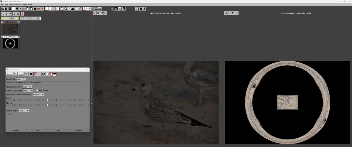

problem : raw develop strange lens correction
Posts: 747
See screenshot of strange lens profile result.
Nikkor Z 24-200 , Nikon Z6 camera body
2025-09-03 PWP raw develop.jpg (55.38 KiB) Viewed 77935 times

Re: problem : raw develop strange lens correction
Try deleting all the files in the Lens Profiles settings (C:\Users\<user name>\AppData\Local\Picture Window Pro\Lens Profiles. This will force PWP to rebuild the lens profiles using the latest database.

jsachs wrote: September 3rd, 2025, 11:28 am Try deleting all the files in the Lens Profiles settings (C:\Users\<user name>\AppData\Local\Picture Window Pro\Lens Profiles. This will force PWP to rebuild the lens profiles using the latest database.
After deleting all files in the folder, the problem persists.
OK, please send me a copy of the raw file.
Posts: 4908
It looks OK here. Can you tell me what are the names, sizes and dates of the files in your Lens Profiles folder?

The lens profiles folder is attached
NIKKOR Z 24-200mm f_4-6.3 VR.lens profile is incorrect (the two index files look OK) -- try deleting it and doing a Raw Develop again.

jsachs wrote: September 4th, 2025, 8:13 am NIKKOR Z 24-200mm f_4-6.3 VR.lens profile is incorrect (the two index files look OK) -- try deleting it and doing a Raw Develop again.
Deleted profile. Problem persists
I tried on a different computer ( laptop ) and the same problem is reproduced.
I think the problem may have to do with the installer leaving some old files around when installing the new lens profile data. One last thing to try -- delete both the Lens Profile and the LensFun/db folders and then re-install PWP.
