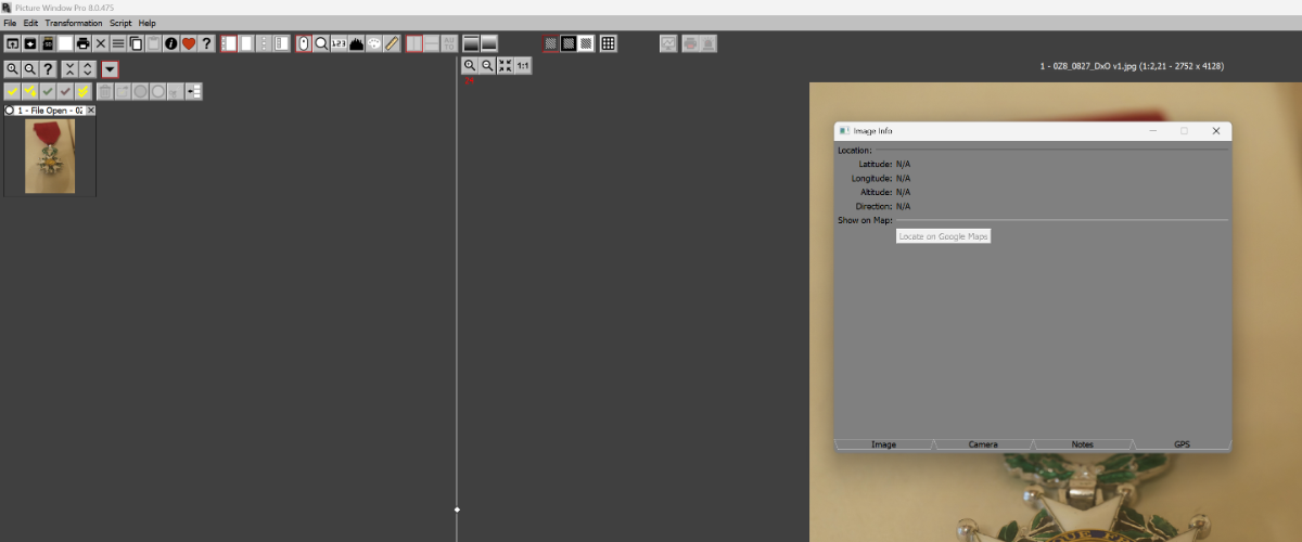

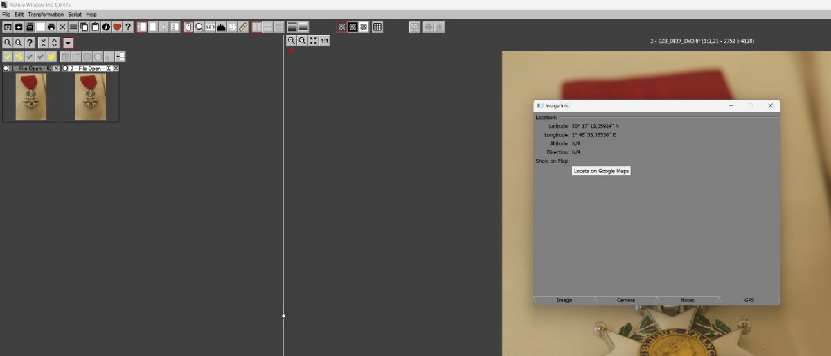

Steps to reproduce :
  • Open TIF file with GPS location
  • Observe image info for the TIF file : PWP shows GPS location valid values
  • Save image to jpg format within PWP
  • Open JPG file in PWP
  • Observe image info for the JPG file : PWP shows GPS location = NA
TIF:
Capture d’écran 2025-01-15 TIF image info.jpg (37.47 KiB) Viewed 2909 times
JPG:
Capture d’écran 2025-01-15 JPG image info.png (176.31 KiB) Viewed 2909 times

Sorry for the duplicate. PWP does write the GPS metadata, but it cannot read it back.
I had verified the JPG file detailed properties using Windows File Explorer, and saw it was missing in the file properties.
Like PWP, Windows File explorer does not recognize the GPS position data in the JPG file.
