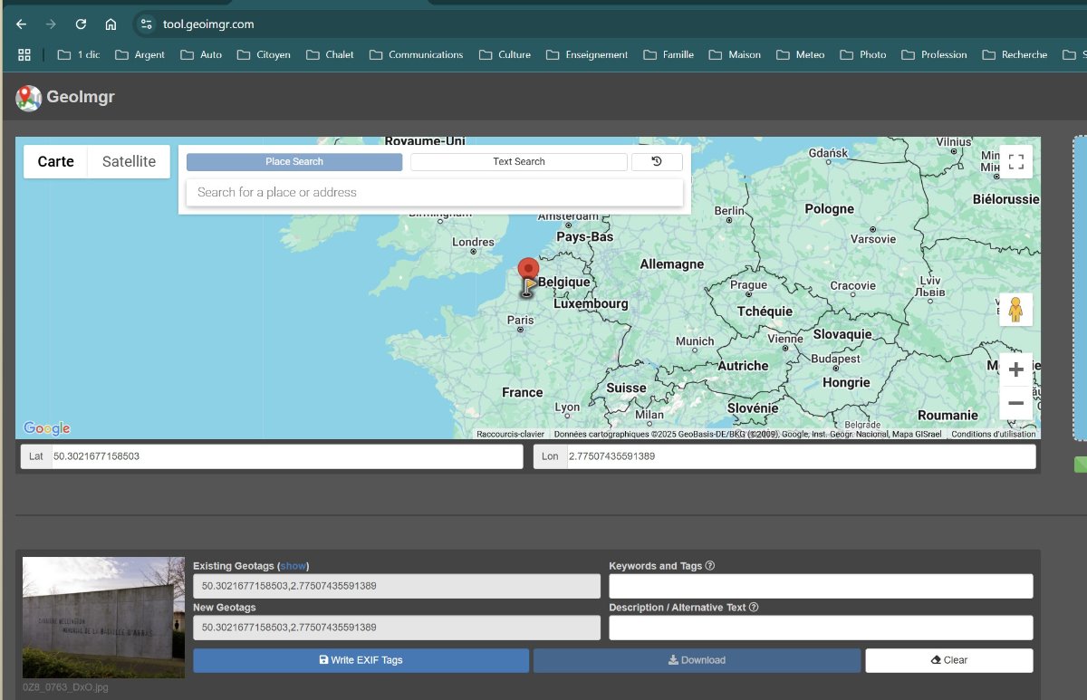

Posts: 744
Re: Image info - GPS Location geotag unrecognized by PWP however recognized by Exiftool
The geotags are correctly found by Web application GeoImgr.com
https://tool.geoimgr.com/
2025-01-08 Web GeoImgr.jpg (135.4 KiB) Viewed 3303 times
Posts: 4886
I checked the file you sent and the GPS data is either missing or is not being correctly read by the Windows codec. Not much I can do as this is not a Picture Window problem. It looks like Photoshop can find the GPS info so it may be a Windows problem. Do you get the same issue with TIFF files?
Posts: 744
The GPS data is not missing since it is recognized by exiftool, by https://pixelpeeper.com/app, and by https://tool.geoimgr.com/
It could be as you suspect a problem with Windows.
Could you change PWP such that it would retrieve GPS position using exiftool rather than from Windows or in addition to Windows ?
Posts: 4886
That's what I am working on.
