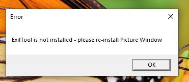

Get an error about ExifTool not being installed...
File can be saved, just without EXIF data.
Seems to work after a 'repair' re-installation... (can confirm that a 'repair' re-installation works. Had to do this on two computers (1 Win10 and 1 Win11)

Did you do a full install or just update the exe file?
The Exiftool installation process was updated recently so I had to change the files bundled with PWP. Without a full install you would get errors.
Assuming you did a full install, it looks like I may be omitting some file that is required.
Posts: 401
Re: Update Available - Version 8.0.442
It was a full download/install.
Posts: 4908
Offhand, everything looks OK -- don't know what could have caused the message. I did see it here the first time I installed the new version, but have not been able to reproduce it.

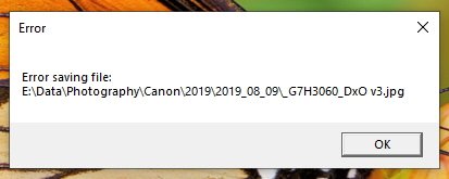

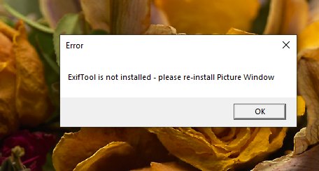

DId a full install. I am seeing the problem consistently - immediately after install, upon closing PWP and re-starting it, and after rebooting my system.
Here's the JPEG Options window showing the settings that I'm using:
And here's the two error messages that appear:
Posts: 4908
I think some minor changes I made may have fixed it since uninstall followed by install now seems to work OK. Will post an update shortly -- let me know if the problem persists.

8.0.443 seems to work without the exif error, for me.
Posts: 401
Confirmed, 8.0.443 works as expected.
