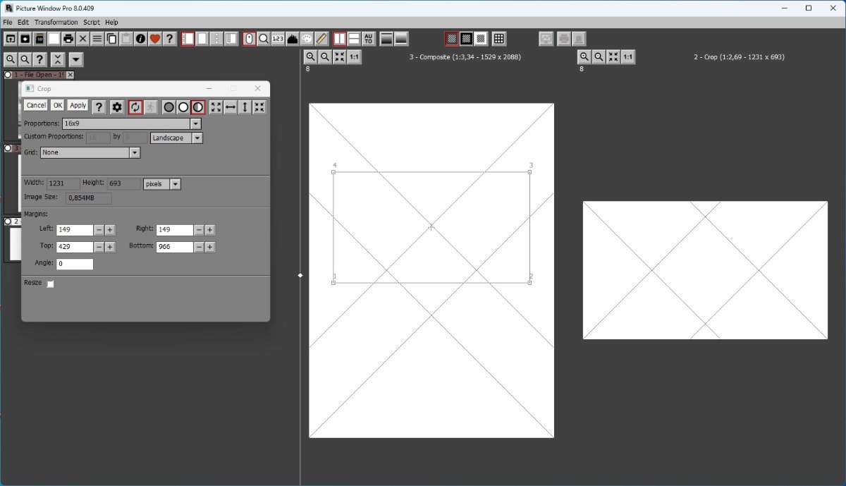

In one PWP 8 setup, the grid lines do not follow the crop rectangle. Any idea of whay might cause this ?

There are global grid settings accessed from the main tool bar which apply to the entire input and output images.
There are also grid settings within the Crop transformation that apply to the crop rectangle in the input image only.
You are apparently using the first type instead of the second.

I overlooked the grid selector in the crop transformation dialog box.
I had established a default grid for the crop tool since a long time ago and had forgotten about it when I used it on a different computer.
