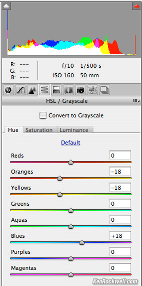

Ken Rockwell has a screenshot of his ACR sliders. It is currently on this page
http://www.kenrockwell.com/tech/00-new-today.htm
while the presumably permanent location of the screenshot is at
http://www.kenrockwell.com/leica/images ... -08-16.jpg :
Rockwell vectors the yellows and oranges away from green. He does not change green itself, which is what DEN's curve does.
On my monitor DEN's curve does not produce the effect Rockwell makes and likes. The curve I showed produces something closer to the style he gets with those ACR tweaks. But DEN set boundaries on both sides of the change, which seems theoretically correct versus the one-sided boundaries in my example.
This discussion helps one understand how one can use the hue curves, and it appropriates language from Rockwell that I find helpful to thinking about images.
It also reinforces the view that the color curves are fundamental tools. Most if not all sliders and other manipulations in various PP programs are equivalent to certain curve changes. They might be convenient, but I think it is a scientific duty of the program vendors to relate their sliders to a common theoretical heritage like color curves. Commerce, though, trumps science.
