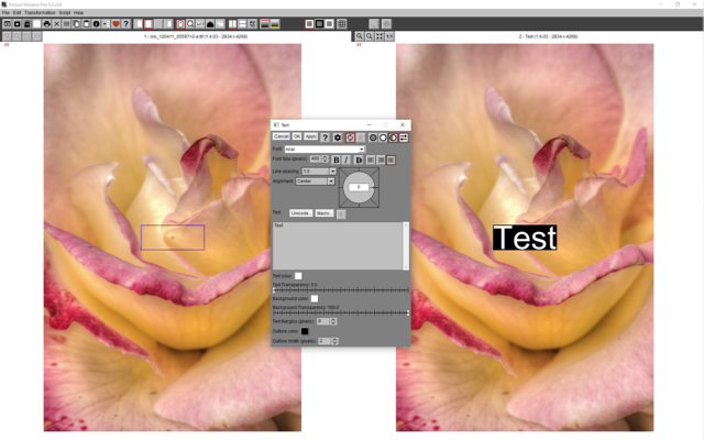

Hello. I installed the 8/12/21, update. I use the text transformation regularly and noticed immediately that the background transparency slider is not working properly. Also, the default background is black when the transparency slider is set at 100%. I've uninstalled and reinstalled twice. I'm thinking a bug might have slipped in on this update. I've included a screenshot.

It looks like there is a problem with 48-bit images -- it seems to work OK for other image types. Will check it out and post an update shortly.
Fixed for next release -- just uploading it now.

Thank you, Jonathan! It works like a charm!
