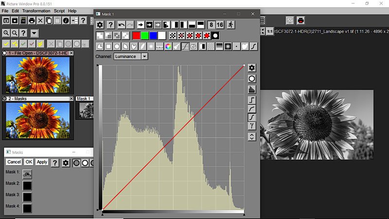

Den, how did you construct the mask for your flower colour correction with colour curves?
Re: Minimize an 'open' Finalized Mask Dialog Box and an 'active' transformation
I was not trying to do anything special... ...just create an illustration. Mask 1 is simply the Luminance channel of the File Open image:
Screenshot (17) v1.jpg (88.29 KiB) Viewed 5044 times
I will sometimes use this as a basis to isolate subsequent Luminance tone ranges and perhaps adjust them to contrast preference with the Mask Brightness Curve.
