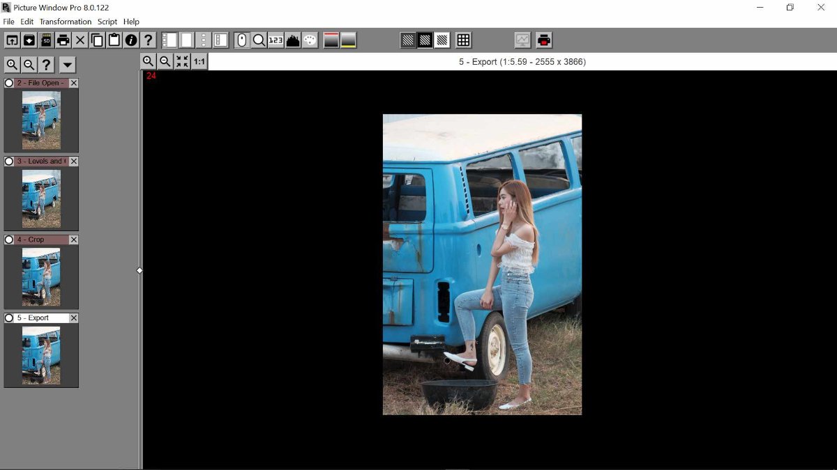

- Posts: 1485
Re: Export transformation, not in a batch
In this scenario, for instance, if I run it in a batch when Export Output is set to 'Clipboard' and I run the batch, the Export output indeed gets copied to clipboard. If the output is set to 'Output Image', and the batch is run, it doesn't seem to produce an image below the Export.
From the Export control panel, I can save its output to file (with Write File button), but I don't know how to 'Write to Clipboard'.
It is not supposed to produce an image below Export -- the output image is the Export.

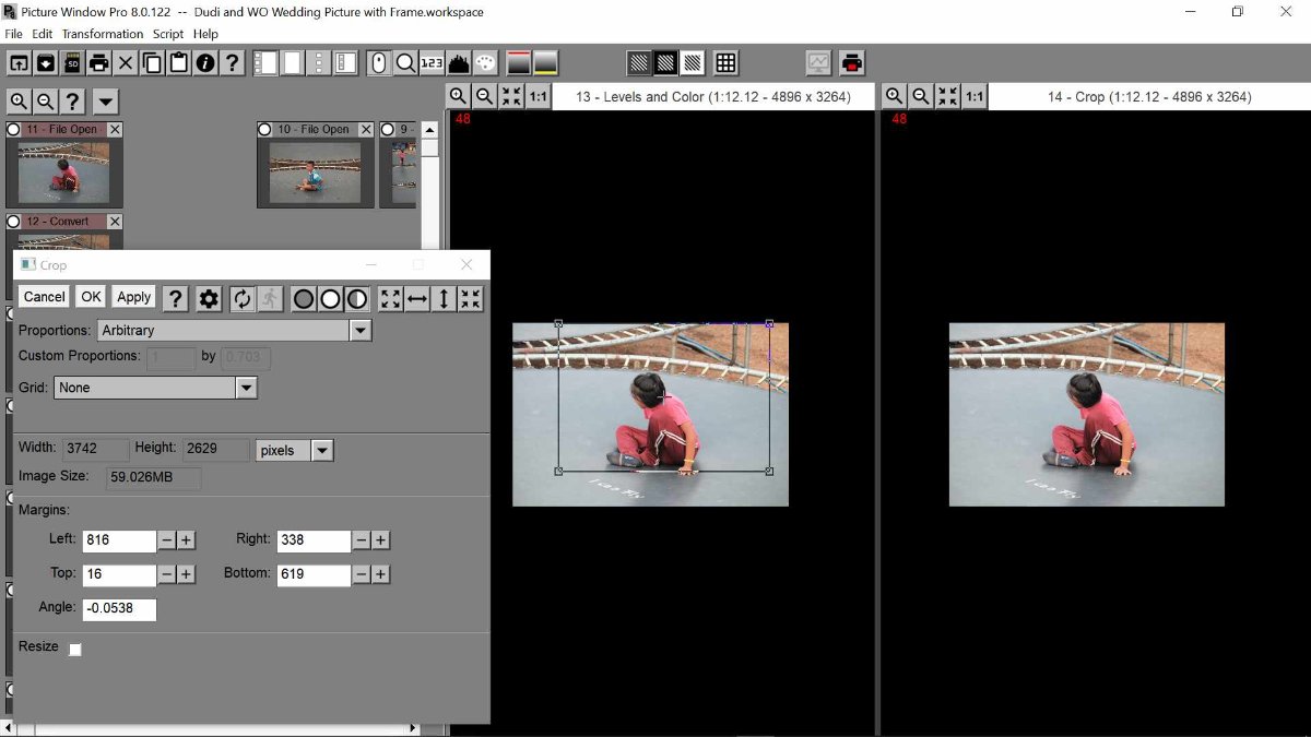

- Posts: 1485
Yes, but if there is only one image in File Open, and there is a Resize transformation somewhere in the branch with the Breakpoint on, and I remove the Breakpoint and I run this single image as a batch, and then open the Rieize, this is what I see. Moving the cropping rectangle a little, sets the preview right.
Also, I don't know where this slight Angle value came from.
- 2020-07-17_220811.jpg (89.14 KiB) Viewed 3630 times
Can you send me the script file you are using and then describe the exact sequence of operations you are doing to get to the screen shot?
