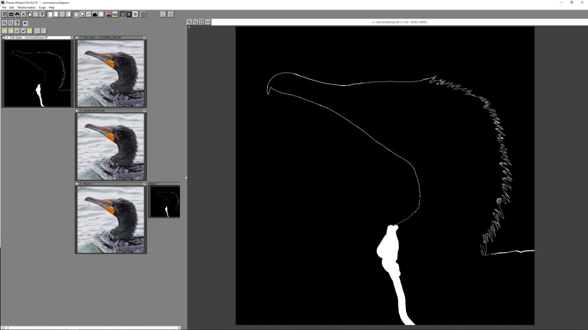

I have a Workspace file that consistently crashes when the Paint Tool is opened. I once again set a custom Mask Default prior to this happening.
I created a detailed edge mask. Saved the mask as a file. Opened the mask file. Then upon the attempt to open the Paint Tool on the mask file (tiff) PWP crashes. Here's what the Workspace looks like on screen:
Attached are zips of the Workspace file and the Mask.default files.

Not seeing it crash here.

It looks like you are still on 8.0.78 -- I did fix a problem with Mask Paint in 8.0.79 -- not sure if it is related.

The forum software seems to mangle the uploaded jpgs. It's 8.0.79 I'm running - upgraded from 8.0.76 prior to starting the edit earlier.
Trying to zero in on parameters that change whether it crashes or not. Not seeing a crash yet running single monitor. Once did not see a crash with two monitors - all other times PWP crashed running two monitors. Not convinced that that's significant yet though, but something is causing the problem to occur intermittently.
