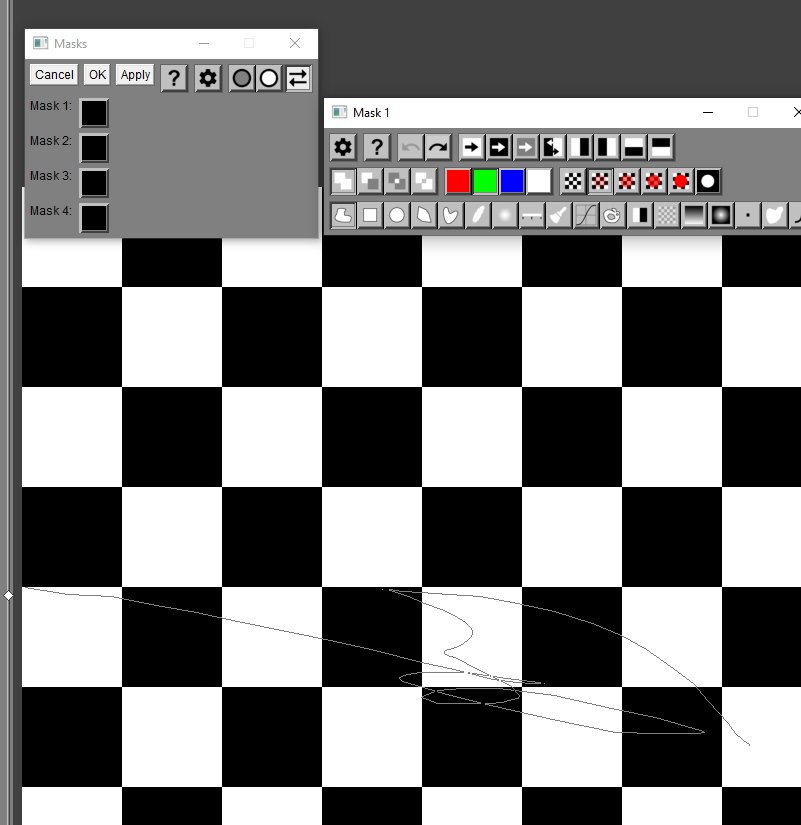

Re: Undoing First Operation in Mask Transformation Shows Prior Mouse Path
Ok. I deleted the mask.default file. With the default mask settings, steps to reproduce the issue are:
1. Open image.
2. Open Mask Transformation.
3. Select "New mask..."
4. Select the Paint operation.
5. Click and release the Paint tool on the image.
6. Move mouse around on image (with mouse buttons released).
7. Undo the mask operation.
8. Note that the path of the mouse from step 6 appears over image. (See image.)
1. Open image.
OK, thanks -- got it now.
