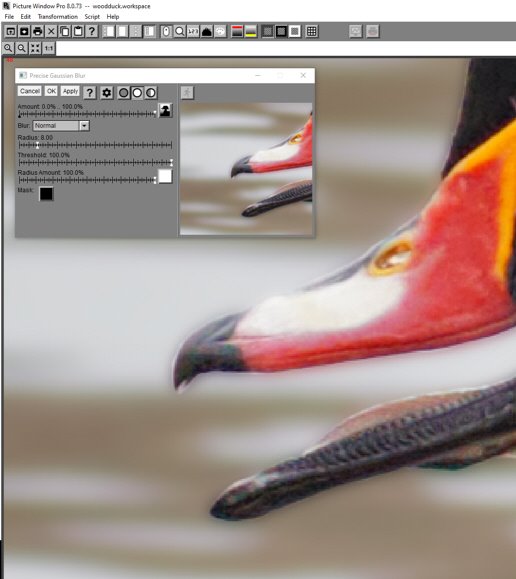

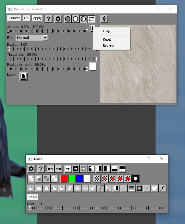

Mask Edit (aka Re-Open Mask Dialog Box) seems to be Missing for Precise G Blur Amount Mask.
See attachment.
Also, I always use the same mask for Amount and Mask. Is there a way to tell PWP to use one mask for both?

If you insert Masks transformation before Precise Gaussian Blur and set one or more masks there, they will be available for all mask buttons in Blur with 2 clicks.

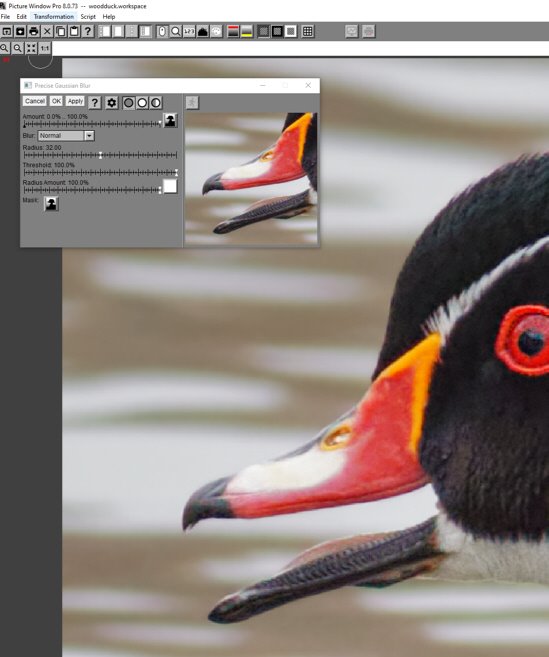

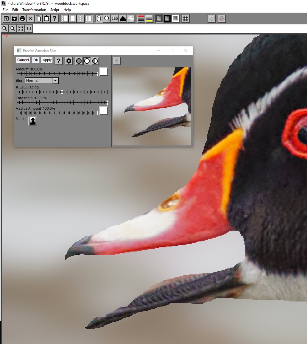

"I might point out that once you set the Mask to identify what you want to blur, you can just leave Amount at 100% everywhere, so you really only need one mask."
That doesn't seem to be the case. When just the Mask is used, there is edge erosion on the image. If just the Amount mask is used, there is a halo around the image. When both are used, all is good. See attached images. Don't know if there's a bug lurking here or not.
