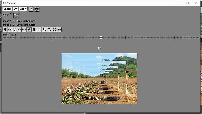

A related observation: when I use the mouse wheel to zoom out the Compare control panel preview, often the previous zooms get stuck below the current zoom (just like on the image below), and refuse to update unless I switch the image, for instance.
And a question: if the image in Compare control panel preview is larger than the preview window, is using side sliders the only way of moving it around? (Alt-mouse dragging works on the actual preview window, but not on the Compare control panel preview).

I fixed the mouse wheel problem for the next release.
