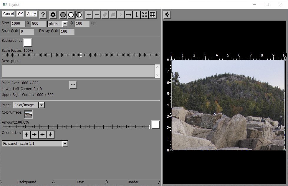

The easiest way to do this is to use the Layout transformation. Once you set it up it takes care of everything.
1) bring up Layout and change the units to pixels, and then enter the desired image width and height.
2) click the + button to insert a new panel and drag its corners or sides to resize it to fill the entire output image. Check that the panel size is correct.
3) select Fit Panel - scale 1:1 as the scaling option.
Save these settings using the Settings menu under a name you can remember for future use or if you need to start over later.
To use it, select the image you want to crop as the Color/Image and then click the side by side button at the top of the dialog box to display the input image in the main image area. You can drag the cropping rectangle overlay as necessary to decide what part of the image you want to keep. Then click OK and Layout will crop the image to the desired size.
Repeat the previous step for the other images you want to crop.
I did find a problem with Layout cropping rectangle while testing this, but if you stick to the above procedure you should be OK.
layout v1.jpg (95.98 KiB) Viewed 2574 times
