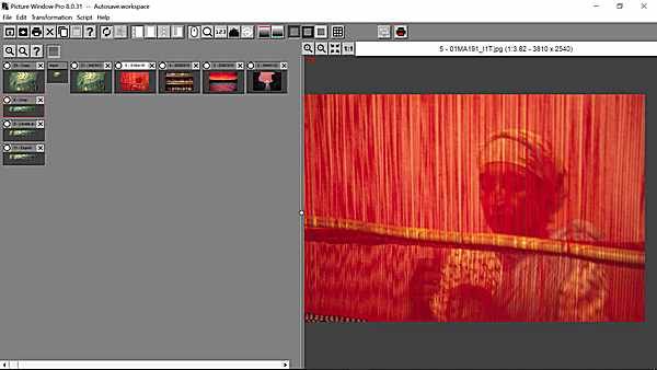

This is how it looks like. I ended up with the Copy option and Write File button in Export for each image in turn - there were only five for this job.
- 2020-01-10_183053.jpg (26.37 KiB) Viewed 1275 times

The easiest way is not not open the other four until you are ready. Then use the Clone Entire Branch command. It will ask you for a new pathname, open the file, and then copy all the transformations below it.
Or, if you don't want to replicate all the transformations, you can double click the File Open and append the other four pathnames to the file list. Then by moving the red dot to an image you want to process and clicking OK, that image will be opened and processed. Then you could turn this into a batch operation if you add an Export.
Finally, if you want to use images that are already open, you could convert the File Open to and Input and then redirect the input to one of the other images.
