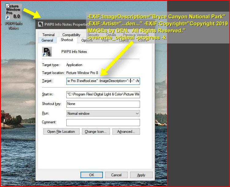

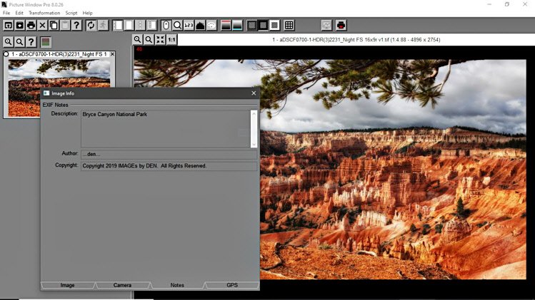

FYI... I like the challenge to learn about PWP8 and how relatively minor knowledge of programming can make Win10 and PWP8 scripting work... so regarding PWP8's Image Info Notes tab additions/edits/deletions...
1) Create a desktop program link to exiftool.exe located in PWP8's program folder. The neat thing here is that it already is a Windows executable and JS has generously not blocked access nor limited its features.
2) In the desktop shortcut link Properties->Target box, add the following ExifTool Options in a string after "C:\....\Picture Window Pro 8\exiftool.exe" leaving a space in front of the first hyphen and each subsequent hyphen:
-EXIF:ImageDescription="Bryce Canyon National Park"
-EXIF:Artist="...den..."
-EXIF:Copyright="Copyright 2019 IMAGEs by DEN. All Rights Reserved."
-overwrite_original
-progress
-k
3) Select Apply after the Options have been added or any changes to them have been made.
The suggested Option list will add/change/delete: ImageDescription; Artist; and Copyright with whatever is between the " " marks; without creating back-up *.*_original files; create a desktop progress report and a program pause so that the report can be read and manually closed.
4) Using Windows File Explorer, select one or more image file names; drag and drop the selection on the ExifTool desktop shortcut. A progress/status report will be generated on the desktop. The image file or files will be updated with no changes to pixel data and remain in their selection folder or folders.
Have fun self-programming a variation of Command Line and utilizing Windows OS features to perhaps better your PWP8 experience.
There are numerous GUI's for exiftool but sometimes its just interesting so see/understand what possibilities are 'under the hood'.
P.S. Noticed a discrepancy in the Options list vs. those in the illustration. A -EXIF: prefix is not always necessary to idendify tag groups with a tag name but it is the best practice.
