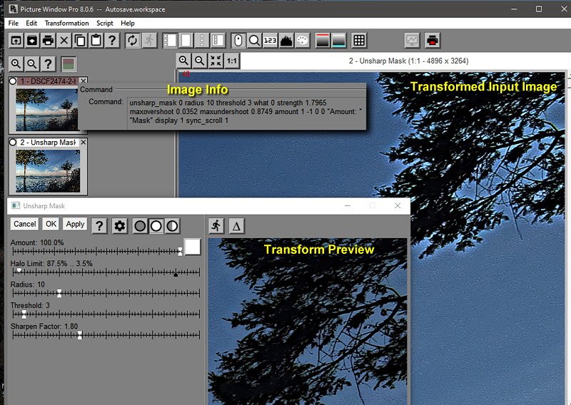

When the Input image is transformed, the Halo Limit values are interchanged... ...but the transform Preview is shown correctly.
Screenshot (2).jpg (135.23 KiB) Viewed 3041 times

I don't see this here -- are you sure you didn't forget to click the running man icon above the preview to update the output image?
Re: v8.0.6 USM Halo Limits interchanged
I clicked the transform's OK button, then double clicked the Browser image to re-open the Transform dialog.
Try this... (1) Open an image; (2) open USM with the settings illustrated; then (3) click Apply... ...the Output image has strong white halos instead of dark halos.... ...the same results as when you click OK.
If you click the Running Man, then the Output image has dark halos like the dialog Preview but OK needs to be clicked to close the transform dialog.
I guess I am somewhat confused regarding the purpose of the Running Man, you already have the OK (traditionally executes and closes a transform dialog) and Apply (traditionally executes and leaves the transform dialog open)... it would seem that Apply and Running Man should have the same results... and are duplicates????

The key factor you left out was that the input image was 48-bit color. It works OK for 24-bit which I was checking. Will fix for next release.
Apply updates the output image and also propagates the changes to all dependent images. Running man just updates the output image. If there are no dependent images, they do the same thing.
