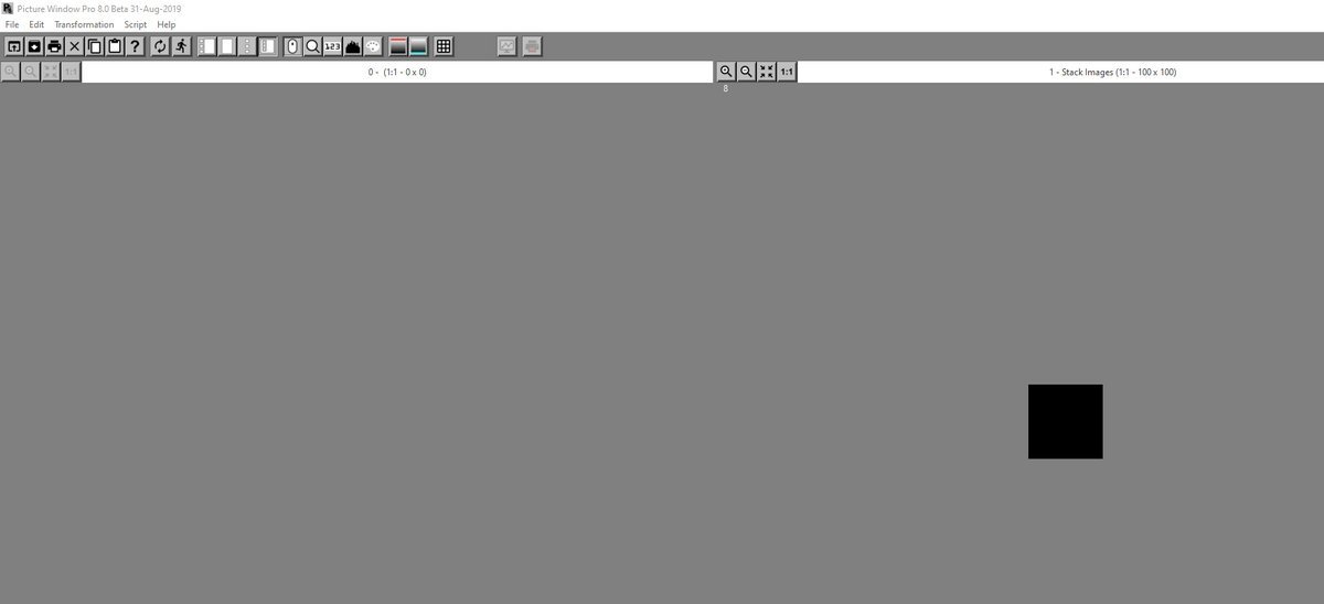

There is a strange black square that shows up in the display preview when Stack Images is first selected from the Transformation menu:
Of course it's replaced with the correct image once the set of images is loaded...
Posts: 4908
Re: Bug fix release 31-Aug-2019
When there are no input images the output image is set to a small black Square.
Posts: 401
Okay, good to know.

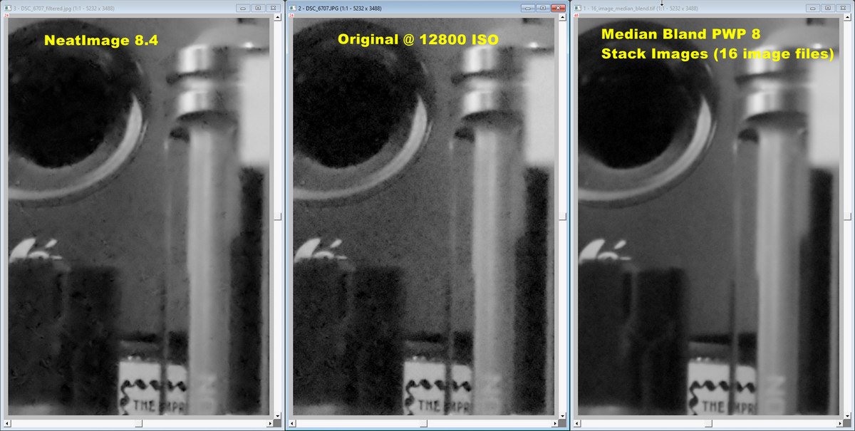

This is a huge time-saver for me. I use the 20-60 frames per second option of the Nikon 1 V3 to record a scene at high ISO, and then use Stack Images and Median Blend to reduce the noise. Being able to load up 16 images in one step really helps.
Thank you.
Posts: 4908
I would expect Blend mode to reduce noise slightly better than Median, but I could be wrong. Have you tried both?
Posts: 401
Yes I have tried both methods, and honestly can't see any difference between the results. Except where some detail has moved between images, so Median removes the ghost, where Blend can leave a faint ghost behind. The level of noise reduction seems equal.
Compared to NeatImage 8.4, which is my go-to noise reduction software, Stack Images achieves far superior results. NI is very, very good for most circumstances, but with a large series of images taken within a second, Stack Images is amazing.
NR results compared:
Posts: 4908
Thanks for posting those examples.
