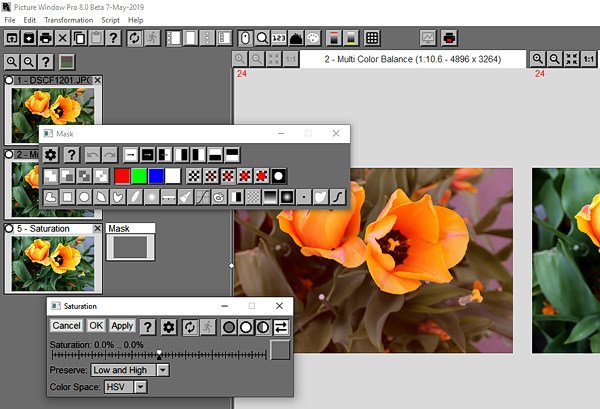

When selecting a New mask with the Saturation transform, the mask background defaults to a 50% gray rather than having expected black/white image areas with preference black to gray transitions when settings are made...

That's intentional because the Saturation Amount control is zero-centered -- gray does nothing, lighter than gray increases saturation, darker than gray decreases saturation. Same with the Brightness transformation.

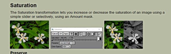

Transformations.pdf --- Saturation:
Saturation Transform 2.jpg (27.67 KiB) Viewed 6297 times

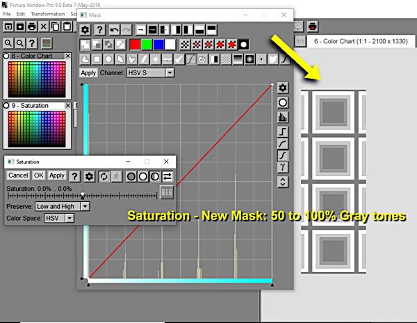

PWP8's Saturation Amount mask using the same settings will only have a 50 to 100% Gray tone range
HSV-S Map with Saturation-New Mask.jpg (59.58 KiB) Viewed 6266 times

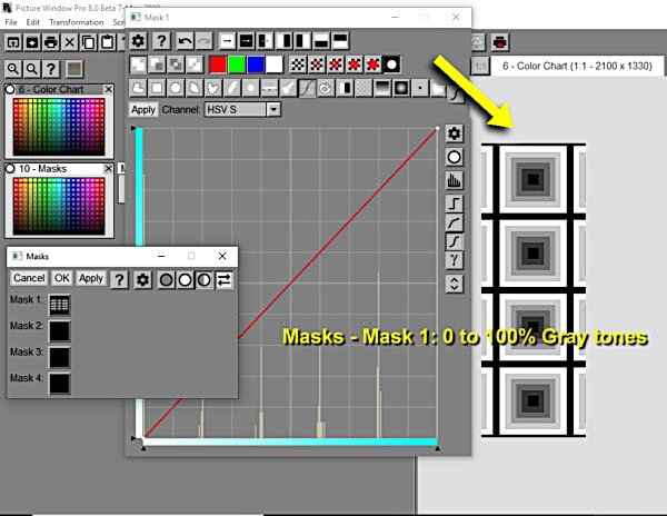

PWP8 Masks transform with the same settings you will have a mask with 0 to 100% Gray tones
HSV-S Map with Masks-Mask 1.jpg (57.32 KiB) Viewed 6266 times

This is because the Saturation mask starts off with a 50% gray everywhere while Masks starts off with a 0% black mask. The Add mode combines the curve with the current mask. If you want to make them look the same, click the button to make the mask black when you start making your Saturation mask.
