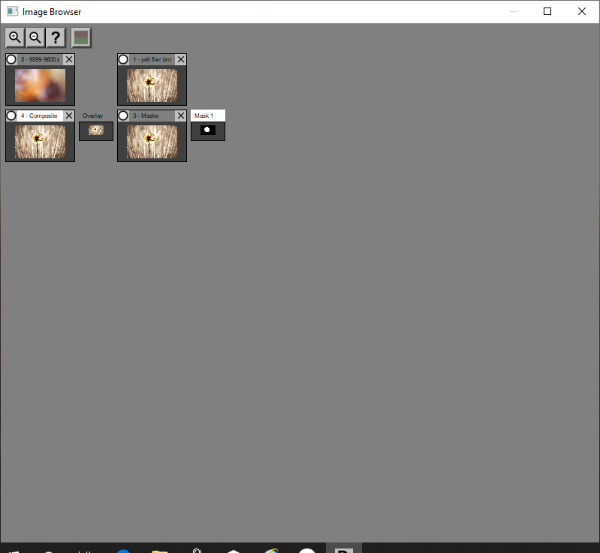

If you post a small screen shot of the image browser, I can see what you are doing.

The problem is not related to 1. so may be the second reason (as I don't know understand enough about this new system).
I have never done a screenshot before, so here goes:
2019-04-29 (1).png (48.29 KiB) Viewed 3015 times

Actually, what you are doing should have worked -- I have fixed the problem for the next release.
In the meantime as a workaround, if you save the mask in a file (click the gear icon in the mask dialog box and select Save mask as image file) and then open the mask image file, you should be able to use it.
A even simpler workaround is to not use the Masks transformation to create the mask, but instead to just select New Mask for the Overlay Mask control and create the mask there.

The screenshot I sent was just a quick workflow that I did to illustrate my initial workflow. And in the initial workflow, I actually did eventually save the mask as an image (after I tried what I described) as I intend to use it on other images.
