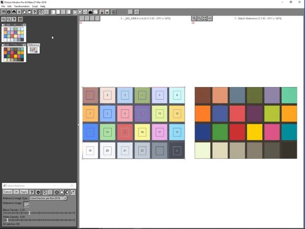

I'm still trying to work with this transform, I've got an IT8 now, with reference file, but my photo setup is all taken apart. So, I'm left with several images of a Pre-2014 Color Checker, and my subject print. When I apply the Match Reference transform to the image of the CC, the result looks pretty close to what I'm seeing (Image 784.jpg).
Screen shot of CC images
Image 784.jpg (30.46 KiB) Viewed 3492 times

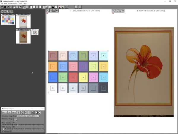

When I try the same transform with my print image, it is not good at all (Image 780.jpg).
Screen shot of print source and reference image / transform.
Image 780.jpg (33.56 KiB) Viewed 3492 times
Suggestions?

Posts: 4893
Re: Match Reference Transform
The image of the colorchecker looks way overexposed, so the correction applied by Match Reference darkens the image which is what you are seeing.
It is important that the image of the colorchecker and the subject be taken under exactly the same conditions and that the exposure be such that neither the darkest or lightest patches of the colorchecker be clipped. You also have to make sure you process the image files exactly the same way and don't for example change the exposure for one of them and not the other during RAW development.
One way to do this is to set the exposure with a gray card, and then shoot the subject and then shoot the colorchecker with the same setup. Or, if you have a mini colorchecker, you can place it in the corner of the subject shot.
