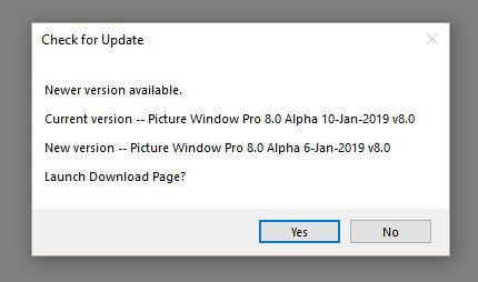

Small side note: Alpha 6-Jan-2019 says " Picture Window Pro is up to date" when I "Check for update"...
And after installing 10-Jan-2019, I get this message when I "Check for update":
Posts: 4893
Re: Bug fix release 10-Jan-2019
Can you try this again, the correct version file is there on the web site and I don't get an error from 10-Jan-2019 version.
Maybe an old copy of the file is being cached on your computer?
All is good now. (Didn't do anything but wait, so it must have been something in memory...)
Posts: 4893
I probably made a mistake when building the 6-Jan version so updating to the next one should fix the problem.
