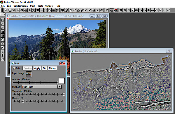

I will:
1) create an initial High Pass image with a large radius, say 50:
Screenshot (1).jpg (276.47 KiB) Viewed 3073 times
2) then depending upon small detail, subsequently sharpen the resulting 1) image with: Sharpen, Heavy Sharpen, or USM with a small radius, perhaps 2 to 5 and threshold 3.

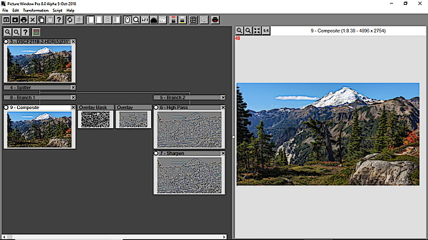

...with the 181005 PWP 8.0.exe update, a High Pass filter was added to the Sharpen transform listing.
Here is a High Pass Sharpen script for your experimentation. It utilizes High Pass with a suggested radius of 50 for a starting image with 4000x3000 pixel dimensions, followed by Sharpen More for the small detail... ...Color Management/Profile settings have been removed... ...yours will be auto-loaded if you sequence through the OK warnings and select YES to convert.
Copy the text and paste to Notepad or BabelPad with UT-8 encoding; then save the file with a *.script extension to the Scripts folder. The script text for 181005 High Pass Sharpen.script:
Screenshot (3).jpg (185.56 KiB) Viewed 3053 times
You may find that the default Composite-Hard Light Input Amount is a bit aggressive resulting in too obvious Light/Dark Halos... ...just lower the Amount from 42.5 and/or adjust the Overlay black/white Amount sliders as they will also control halos.
Ask if there are questions...

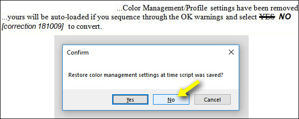

1) As there is a modest interest in this topic, I need to advise a correction to the previous post:
Confirm Clr Mngmt Settings.jpg (105.44 KiB) Viewed 3005 times
Once you have run the script, re-Save it to retain your Color Management and Profile settings.

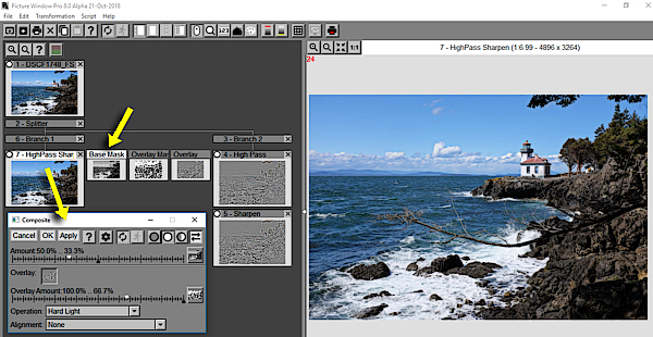

2) As by way of apology... ...an updated HighPass Sharpen.script:
This script provides additional Light/Dark Halo control by using a Input Amount Mask comprising the Input image’s Luminance channel where the white slider controls the amount of Light halos and the black slider controls the amount of Dark halos… …note that at the suggested settings, the Composite-Hard Light blend is biased towards darker halos for both the Input and Overlay images as Dark halos are less objectionable then Light halos…
The updated HighPass Sharpen.script in text format:
Updated HighPass Sharpen.jpg (246.91 KiB) Viewed 3005 times
