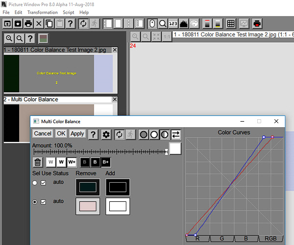

Step 5) Edit Transform display before a manual Reset...
Remove Clrs and Crvs for Img 1.jpg (171.64 KiB) Viewed 2416 times

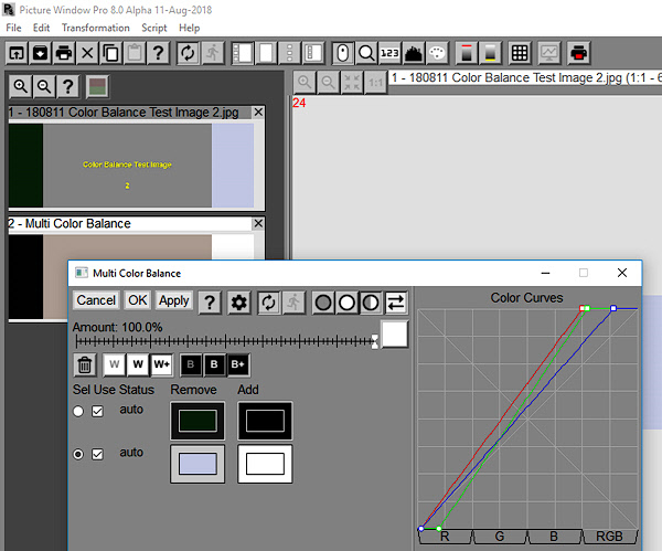

Step 6) Edit Transform display after a manual Reset...
Correct Remove Clrs and Crvs for Img 2.jpg (175.9 KiB) Viewed 2416 times

I see the curves and result changing after a Reset, but I think the problem is with Reset and not with switching images -- will check it out tomorrow.
Re: Script Multi Color Balance-Edit Transformation dialog not auto-updating
Agree that the transform in its script version is correctly producing the desired output image but its transform dialog display may be showing Settings-Reload Last Settings for the Remove colors and curves instead of the those used for the current input image... ...until a manual Settings-Reset or Reload Last Settings is selected. The conflict may be with Reset and/or Reload Last Setting commands...
...also Reload Last Settings may not be working properly because clicking it corrected the transform display the same as clicking Reset.
