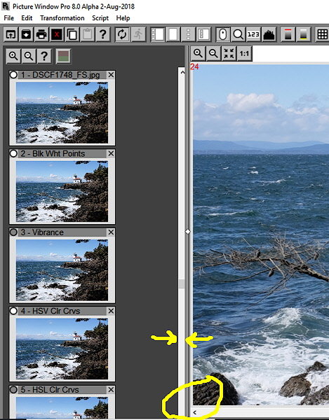

No bottom elements to Browser display vertical scroll nor does the mouse wheel control scroll as before after a click in a blank Browser area. Did not check the horizontal scroll.
Realize that Browser area is a premium but I find it difficult to mouse click in the current scroll width although it might just be that my hand is not as steady as it once was...
...could perhaps the arrow keys and/or the numlock arrows also control vertical and horizontal scroll?
180802 vert scroll.jpg (291.27 KiB) Viewed 3528 times

I fixed the mouse wheel problem. It turns out I need to rewrite a lot of the code related to the browser scroll bars and some other things that were not working.

I think I have fixed all the remaining image browser display and scroll bar problems - will upload a new release later today.
