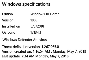

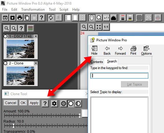

Re: Help without contents?
PWP 8 msi 180503 with PWP 8.0.exe 180504
same observations as MarkT using...

A click on program/transform/tool "?"s results in only the Help index/search without any content texts. A desktop link ["C:\Program Files\Digital Light & Color\Picture Window Pro 8\Picture Window Pro.chm"]
to the chm file will provide content...

It is as if perhaps "Name="s tags are being ignored.
