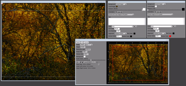

Here is another option using the Layout transformation.
Screen Shot.jpg (213.49 KiB) Viewed 8927 times
I set the layout size to 15x10cm and created two panels:
The first panel holds the image and fills the entire layout and is set to scale and crop the image to fit the panel.
The second panel is totally transparent but has a 0.05cm red border around it and is 13 x 8.6cm, centered in the layout.
When you select an image for panel 1, a cropping rectangle is displayed on it with the proportions 15:10 which you can adjust to determine what part of the image will fill the layout. Making sure panel 2 is in front of panel 1, the red border is displayed where the frame opening will be.
For each image you want to process, you just need to select it into panel 1, adjust the cropping, and click Apply.
The version of PWP I am using here may differ slightly from the latest release version. Sorry the image is so small, but the message board has storage limits. Let me know if you want me to email you a larger version or I can email you the saved layout settings file .
