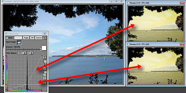

Perhaps you could also consider using the Color Curves transform in either the HSV or HSL color space and adjust the Hue curve with a 'broken line' from blue to yellow or a straight horizontal line at yellow or 16.7% vertical... ...this way the Value or Lightness or Saturation channels will essentially remain unchanged as will their respective histograms... ...den...

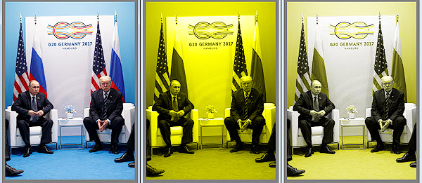

P.S. Was curious. Did a comparison: left-original; center-cln file; right-Normalized HS-Luminance

The color curves - could not get a "clean" yellow, no matter how hard I tried and where I moved the point(s). The results were similar to the "muddy" green (or whatever the color is) that shows in Den's example of the sky and eagle.
Building the colorline with data provided by Jonathan - this was, by far, the closest to what I was looking for. However, the initial attempt was too "blocked up" and destroyed the subtle transitions in darker areas. I tried reducing the contrast of the extracted black and white image first (by using Levels and Color and moving the left point to the right), then moving the Tint point 2 to the left until it looked good. This result was pretty darn good.
