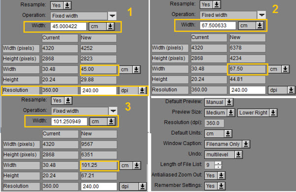

Re: Resize
Kiril,
no problem at all. Until recently I always worked with one resolution 360 dpi. Only now when I start using 240 dpi for printing did I come across this. I mostly use different values so as I say, no problem, just curiosity.
Den,
My preferences: see the image
My Resize test defaults:
Resample = yes
Fixed width = 0 *
Resample method = Nearest Neighbor (makes no difference)
Resize window:
Set the Operation to any using image dimensions: width, height.....
Use inches, cm or mm, not pixels.
* Non zero in Fixed width is automaticaly multiplied by the resolution ratio. Zero value must replaced by a valid value.
Now, if anybody really cannot reproduce the same by following these steps, then it must be just my PC quirk:
1. open the Resize loaded with an image that has the resolution in the file information less then the default in your Preferences (My image had 240 dpi).
Since the default in the Preferences is higher, you will get the Current / New Resolution values in then Resize window something in the way I got: 360.00 / 240.00. (image 1).
2. Press Cancel to close the Resize
3. Reopen the transformation. Now the Fixed Width has grown to 67.5. (image 2)
4. Press Cancel to close the Resize
5. Reopen the transformation. Now the Fixed Width has grown to 101.2. (image 3)
and so on. With each reopen the previous value is remembered and multiplied by the Resolution ratio.
If the target resolution is bigger then image resolution, the dimensions will naturally shrink.
If I change Remember settings = No then the image growing stops, which is expected. Setting it back to Yes restarts the image growing.
Clearing the Resize Defaults followed by resetting the Resize has no effect except that it needs first to set the Operation to any working with dimension parameters (width, height).
David

Re: Resize
OK, David, let's see if you can follow this -- using your panel #2 for the mathematics.
You have told the transformation that you want the resulting printed output to have a width of 67.50 centimeters. My conversion table says that there are 0.3937 inches per centimeter. So that means that you have specified an output with a width of 26.57475 inches. (i.e. 67.50 cm times 0.3937 cm/in = 26.57475 inches)
We have to convert to inches because you have also specified that everything should be adjusted to 240 dpi. And dpi means dots (pixels) per INCH. So we have to now be working in inches.
Now, if we want an output width of 26.57475 inches to contain 240 pixels in each of those 26 inches, we need 6,377.94 pixels in the width of our image. (i.e. 26.47475 inches times 240 pixels per inch = 6,377.94 pixels)
As you can see, the transformation has accordingly adjusted to a width of 6,378 pixels. It will resize the image to convert (expand) the 4,320 pixels in the width of your original image to 6,378 pixels. The same mathematics works in your other examples.
So you have specified a width for the printed output and specified the pixel count standard to be forced into that output width (i.e. 240). The software has dutifully adjusted the number of pixels to accommodate those specifications.
Hope this helps,
Doug
