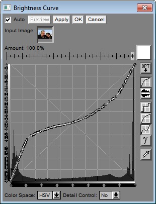

Compositing curves
There is one possible improvement that I can think of: when two curves are composited, there are a lot of adjustment points on the resulting curve - likely the result of having to calculate the curve's complex shape. If I don't wan't to adjust them, that's OK, but if I wan't to move the resultant curve a bit, I can't do it because there are too many nodes.
Cheers and thanks for the upgrade!

Posts: 4886
Re: New Picture Window Release
Unfortunately, the only way I know of to composite two curves accurately that works in all cases is to have 256 control points. Maybe there is a way to selectively remove control points without affecting the accuracy too much.
Posts: 4886
I was able to find a way to reduce the number of control points significantly by allowing some error in the composite curve. This should find its way as an option into the next release.
