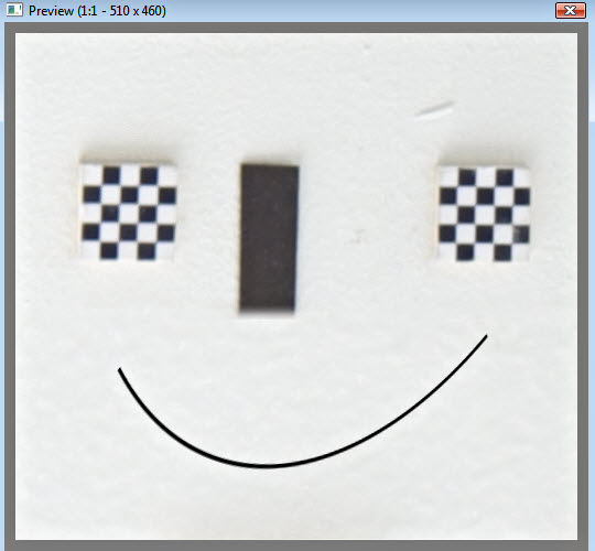

Hmmm... Hmmm... There are curves, then there are curves...!
1) Create a Curve Line image using MS Paint on a 50% tone background with an initial preference Line color/width...
2) Open an Input image and the Composite-Hard Light transform with the Curve Line image as the Overlay and Alignment = 3-point (shift/rotate/scale/shear)... ...Use points 1 and 2 of the Input image to locate curve end points... ...Use point 3 of the Input image to shape/skew/invert the curve...
;-) ...den...
Re: Drawing a Curved Line
P.S... ...originally I had thought about suggesting that the curve be added to the Input image using MS "Paint.exe" to simplify the workflow but by using PWP's Composite-Hard Light transform, the Input image's: color bit depth, color profile, meta data [EXIF/IPTC] and file type should be preserved.

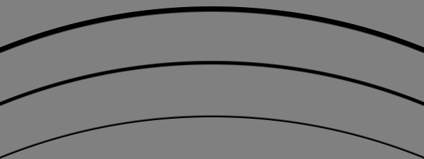

The following Curved Line image with 2.5, 5.0, and 7.5 pixel wide lines was created in PWP using the Line transform and the Fan transform with Curvature=25.0... ...Feel free to download and use with no restrictions...
To use:
1) increase or decrease curvature with the Fan transform with a 50% gray tone fill background...
2) Paint over the non-preference line widths with a 50% gray tone Paint brush...
3) When used as the Overlay image in the suggested Composite-Hard Light transform in the OP... ...relocate if necessary the 1 and 2 Alignment points to the prefered curve ends...
4) Line color can be changed in the resulting Composite-Hard Light transform image using the Flood Mask Tool with an Invert; then Paint with a color of choice [as long as the composite image area is not black next to the line]...
Wavy lines are easiest created with the likes of MS Paint... ...reconizing that the output image may be limited to 24-bit sRGB colors with no comments or profiles and possible compression artifacts...
...enjoy...

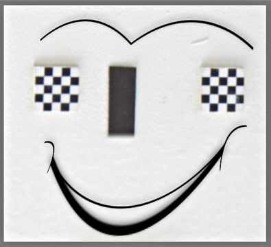

Continuing to explore possibilities utilizing Tile, Drop Shadow, and 4-point Composite-Hard Light Alignments
of the suggested "3 Curve image"...
