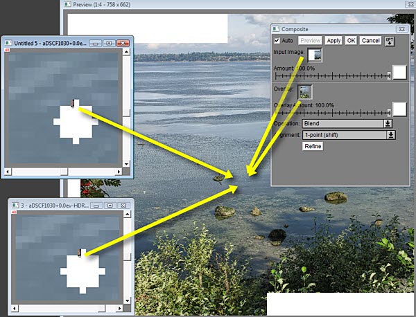

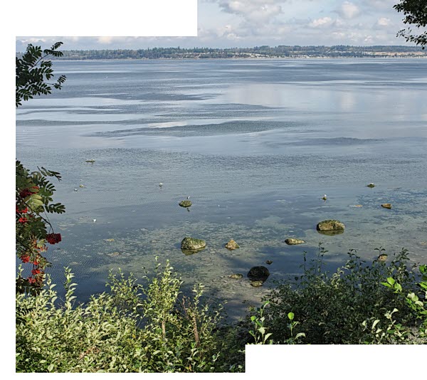

The following is an example workflow I will use to precision Composite-Blend two overlapping images with an "1-point (shift)" Alignment...

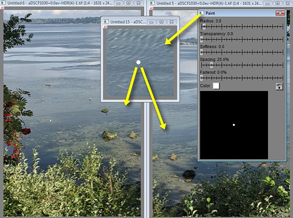

1) Paint a small 0.0 Transparant/0.0 Softness "spot" that will be the common point of Alignment on each of the two overlapping images, Left and Right...
2) Select the Right image and add borders sufficient to contain the Composite-Blend overlapped image... ...This image becomes the Input image of the Composite-Blend transform.
3) Open Composite-Blend with the Input the resulting 2) image and the Overlay image the Left overlap image... ...Select "1-point (shift)" Alignment and initially set the Overlay Amount = 50%... ...move the "1" alignment point in the Left and resulting 2) image to a common pixel of the Paint "spot"... ...move one or the other until there is no apparant shift in the Preview when the Overlay Amount is 100 or 0%... ...click OK with the Overlay Amount = 100...
4) Trim excess borders and clone out the Paint "spot".
"1-point (shift)" Alignment is a simplified case for illustration but I have been successful doing a similar process with two overlapping images and "2-point (shift/rotate/scale) Alignment, i.e. two Paint alignment "spots"... ...although if rotation and scaling occurs, the Overlay image portion may soften and require a slight amount of sharpening to match the Input image portion if it essentially remained unchanged.

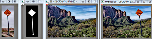

For poistioning Object masks in Composite Base images, try...
1) Instead of a Composite-Blend OK when you place an Object (Overlay) with a mask in a Base (Input)... ...do an Apply...

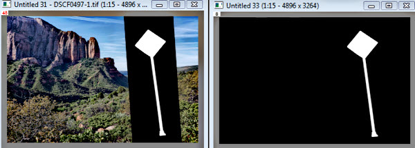

2) then change the Overlay image to its mask image with Amount = 100 without making any changes to Alignment... ...do an OK... ...you will have an image that looks similar to:

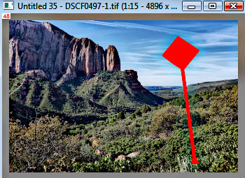

3) create an 8 bit BW image from the resulting 2) image... ...this image can be used as a mask and is precisely aligned so that changes are only made to the imported Object of the resulting 1) image even if Alignment points are outside the Base image dimensions...
