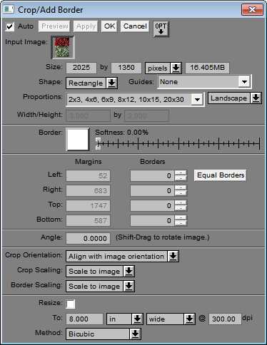

I'm not sure if this is related: in a Crop/Add Border widget, if the proportions are fixed, and there is a Break point set on this widget, if the training image is e.g. horizontal and the next one is vertical, the cropping rectangle properly changes orientation. But as soon as I touch this rectangle to resize it, it changes to the orientation of the training image back to whatever it was for the training image.

This does not happen when I try it -- the crop rectangle is stable. I am using the following settings: Align crop to image orientation; Scale Crop Rectangle and Scale Borders. Since crop has many other settings a well, perhaps you can send me a screen shot of your crop dialog.

Re: Cropping an Image
Screenshot attached. What happens is that when the image orientation changes, so does the crop orientation, until you touch it. Maybe there is something else that I'm doing wrong...
Thank you for posting the screen shot.
The reason the rectangle realigns is that you have chosen Landscape under proportions. This choice supercedes the 'align with image orientation' choice. (The choices are incompatible, so one or the other has to take precedence.)
Currently there is no way to set definite proportions and make them align with the image orientation. The workaround would be to process landscape and portrait images separately. This can be done by selecting images that you want cropped to the selected orientation and then applying the work flow to 'Selected Images' in one operation. Then in a second operation, resetting the orientation in 'Proportions' and applying the workflow to the rest of the images. (There is no need to make a selection for the second operation, since the images already processed will be checkmarked and bypassed.)
Note that if you are using arbitrary proportions, the rectangle does automatically align with image orientation if that choice is made.
